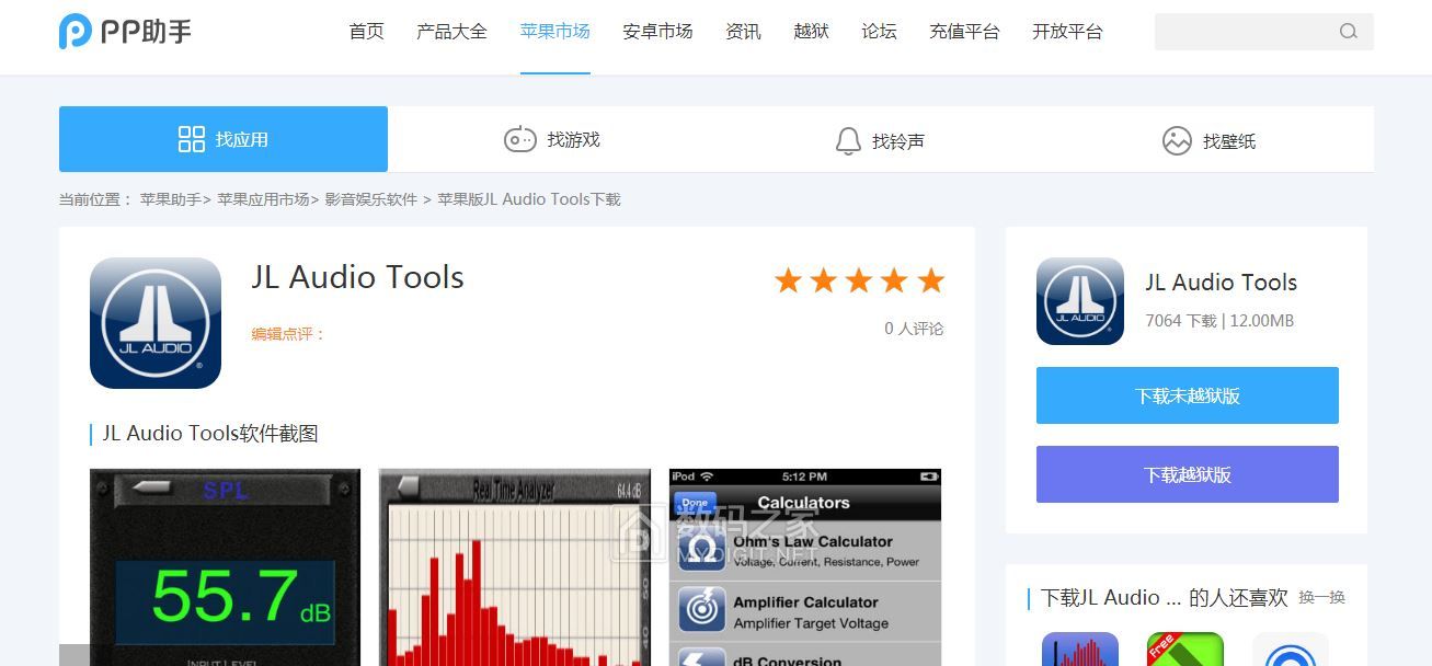

曾经买过相位仪,用于测试汽车扬声器接线正负,发帖子后发现大家好评比较多。在论坛回复中,坛友joke1105说到了iOS平台有一款软件可以做相位仪使用,于是我自己做了一下功课,发现真的可以,在此开贴给广大车友普及一下,有苹果设备的就可以不用买专门的相位仪啦
软件名称叫JL Audio Tools,是一个英文软件,PP助手上就能搜到,不过界面很简单,稍微有点基础的就能看懂,如下:再谈汽车音响调试专用相位软件JL AUDIO Tools,苹果ios坛友的福音!

JL Audio Tools简介
JL Audio Tools is a set of great car audio analysis helpers.
It includes an SPL Meter, RTA, and Speaker Polarity tester. Also, you get four audio calculators designed to help with car audio installation and test.
SPL, RTA, and Polarity are all fully functional tools, and they can all be upgraded to full professional-grade audio test tools.
SPL is a great digital SPL meter, with special microphone compensation built in to correct the iPhone and iPod touch mic, to get the best possible readings. SPL Upgrade adds A and C weighting, octave band weighting, ANSI Slow, Fast, Peak, Impulse, and LEQ modes, and the ability to store readings.
RTA is a 1/3-octave band Real Time Analyzer, including mic compensation to show the flattest possible readings using the iPhone and iPod touch mics. The upgrade adds a cursor, pink noise generation, Octave mode, different decay modes, noise curve overlays, and more.
Polarity lets you check your speaker polarity, using a waveform that you can download at our website. The upgrade adds filters for woofer, midrange, and tweeter, and generates the test signal internally.
Like all sound measurement apps, accuracy varies somewhat between devices, and some models of iPhone and iPod touch don't include mics.
All of these modules were built using the advanced engines from Studio Six Digital.

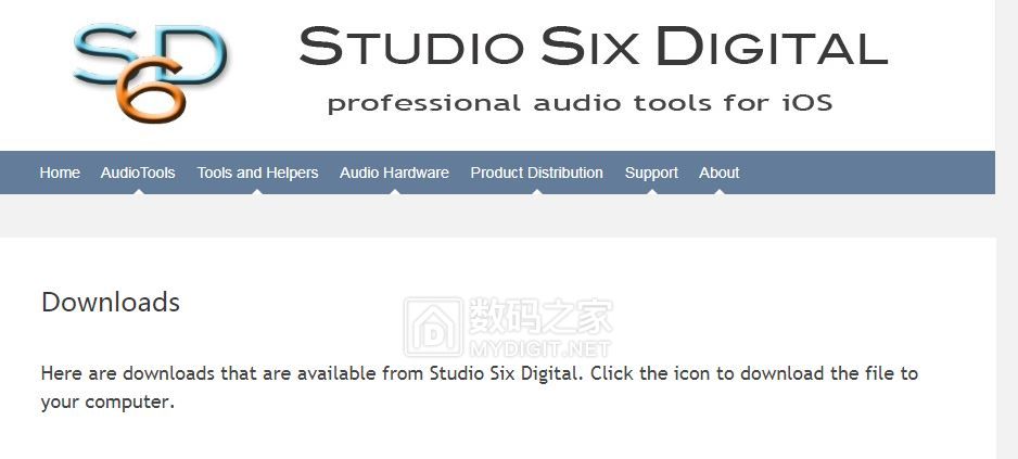

其中红色字体就是关于扬声器极性测试的。意思是去一个网站Studio Six Digital下载声波文件,用车机播放,然后用苹果设备当作相位仪靠近喇叭就可以测试正负相位了。坛友joke1105如果仔细阅读一下软件里最底下的说明,应该能比我早点发现这个啦。网站界面如下:再谈汽车音响调试专用相位软件JL AUDIO Tools,苹果ios坛友的福音!再谈汽车音响调试专用相位软件JL AUDIO Tools,苹果ios坛友的福音!

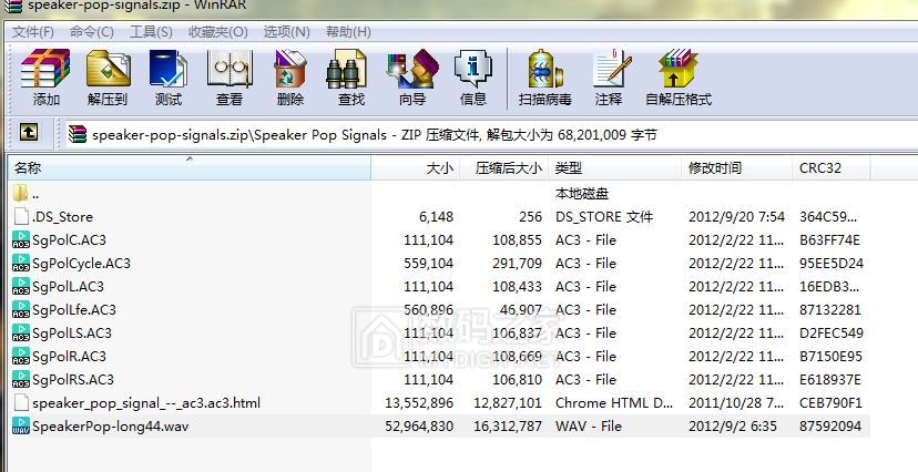

下载中间这个zip文件,里面有各种声音文件,别的不用管,把那个最大的wav拿出来就行,再谈汽车音响调试专用相位软件JL AUDIO Tools,苹果ios坛友的福音!
此文件长度5分钟,50多M,体积太大传不上来,压缩了一个MP3给大家试试看吧,两个一起下载然后解压缩即可。 扬声器极性测试.part1.rar (2900 K) 下载次数:6 扬声器极性测试.part2.rar (272 K) 下载次数:7
