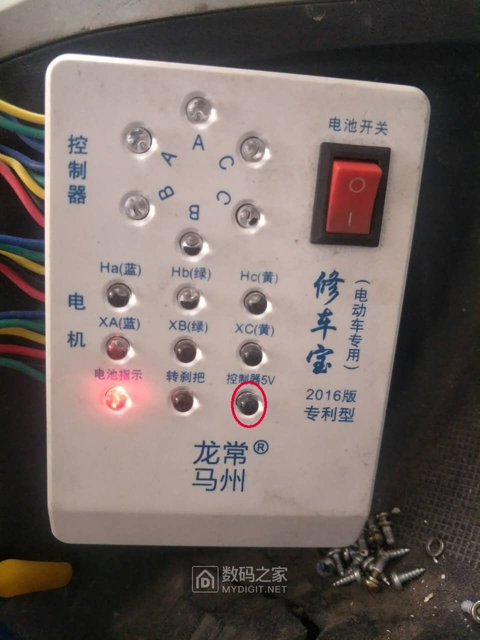

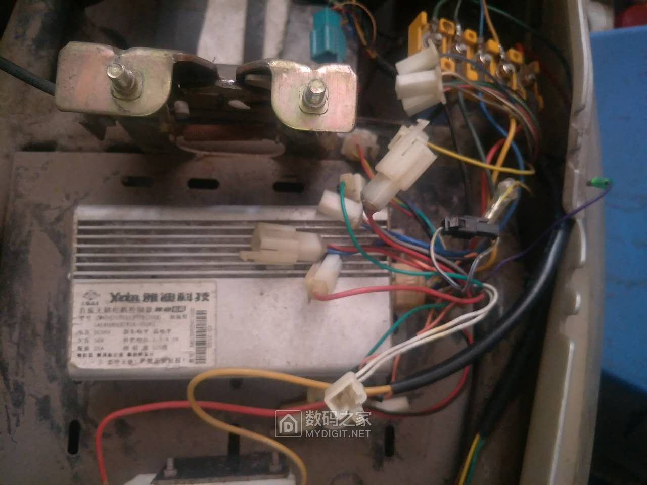

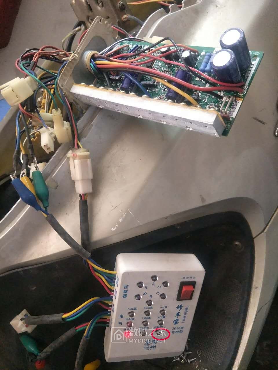

[size=3]一台雅迪电动车不能动了,手拧转把车轮轻微倒转一下便不动了,用修车宝来测试:[/size]
[size=3]
[/size]
[size=3]
[/size]
[size=3]
[/size]
[size=3]
[/size]
[size=3]测控制器无5V输出,以为是控制器的问题,比较难啃,反正也还有一辆电车在用,就暂且丢下了。[/size]

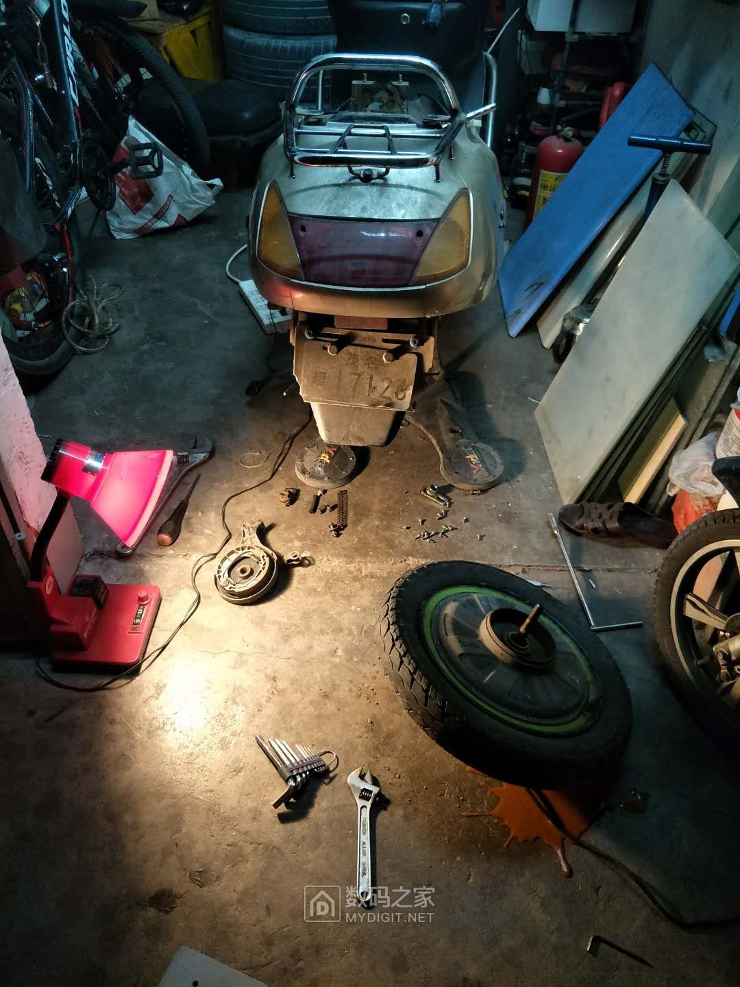

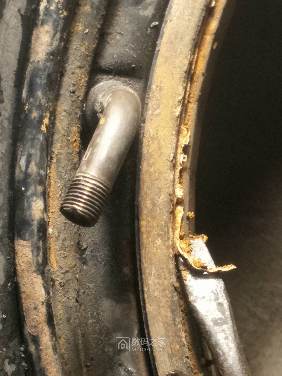

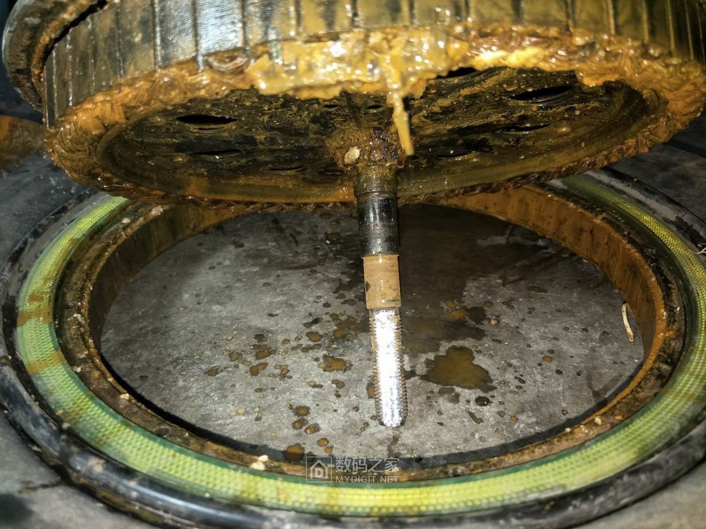

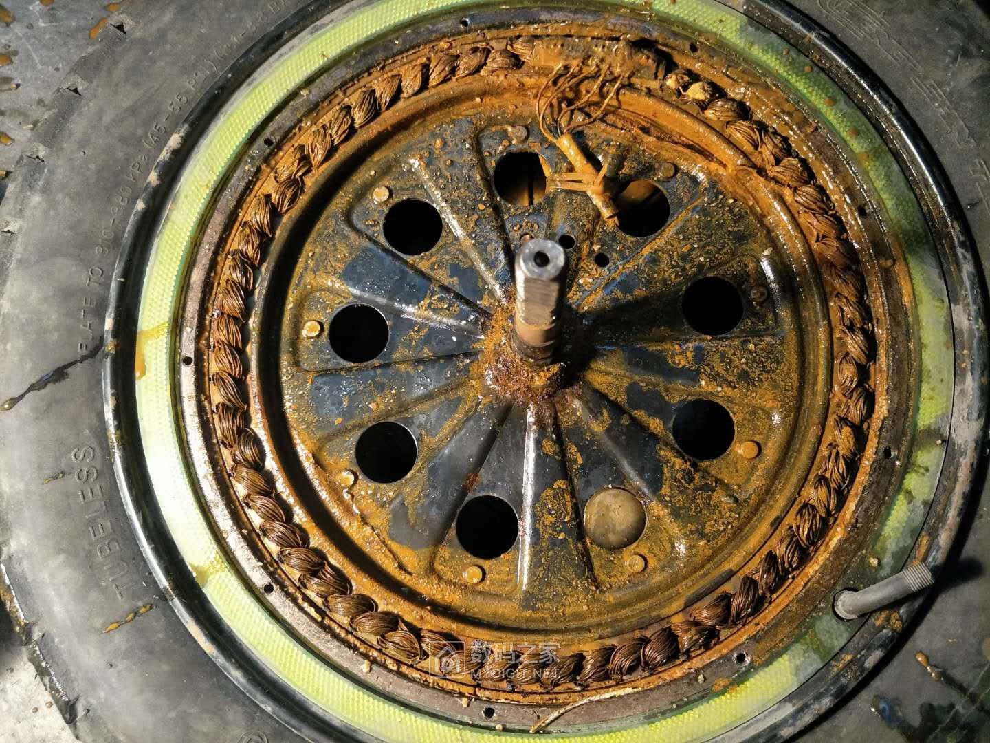

[size=3]直到最近,电动车说要上牌,LP催着要把它修好,重新拆修,却发现后轮不能动了。没得说,拆,结果,又发现一个惊人故障。[/size]

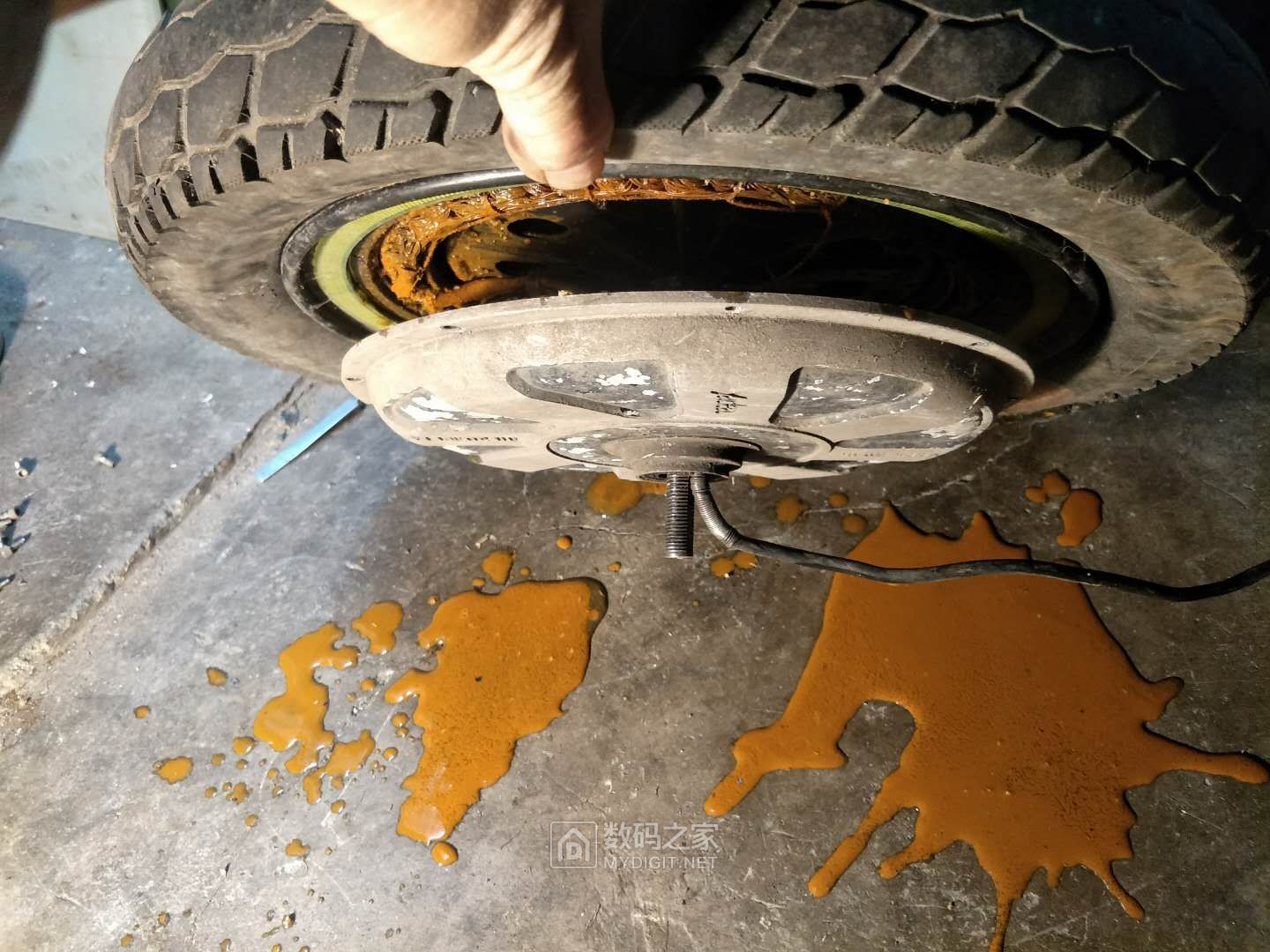

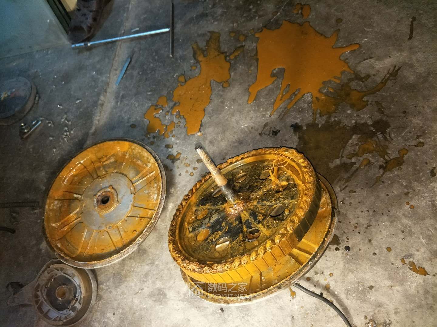

[size=3]因为赶着第二天,最后一天的免费上牌期限,连夜抢修。当车轮转不动时,马上把轮子拆下,才把端盖轻微[/size][backcolor=#ffffff][color=#333333][size=3]撴开一下,便从电机里面漏出一滩黄水:[/size][/color][/backcolor]

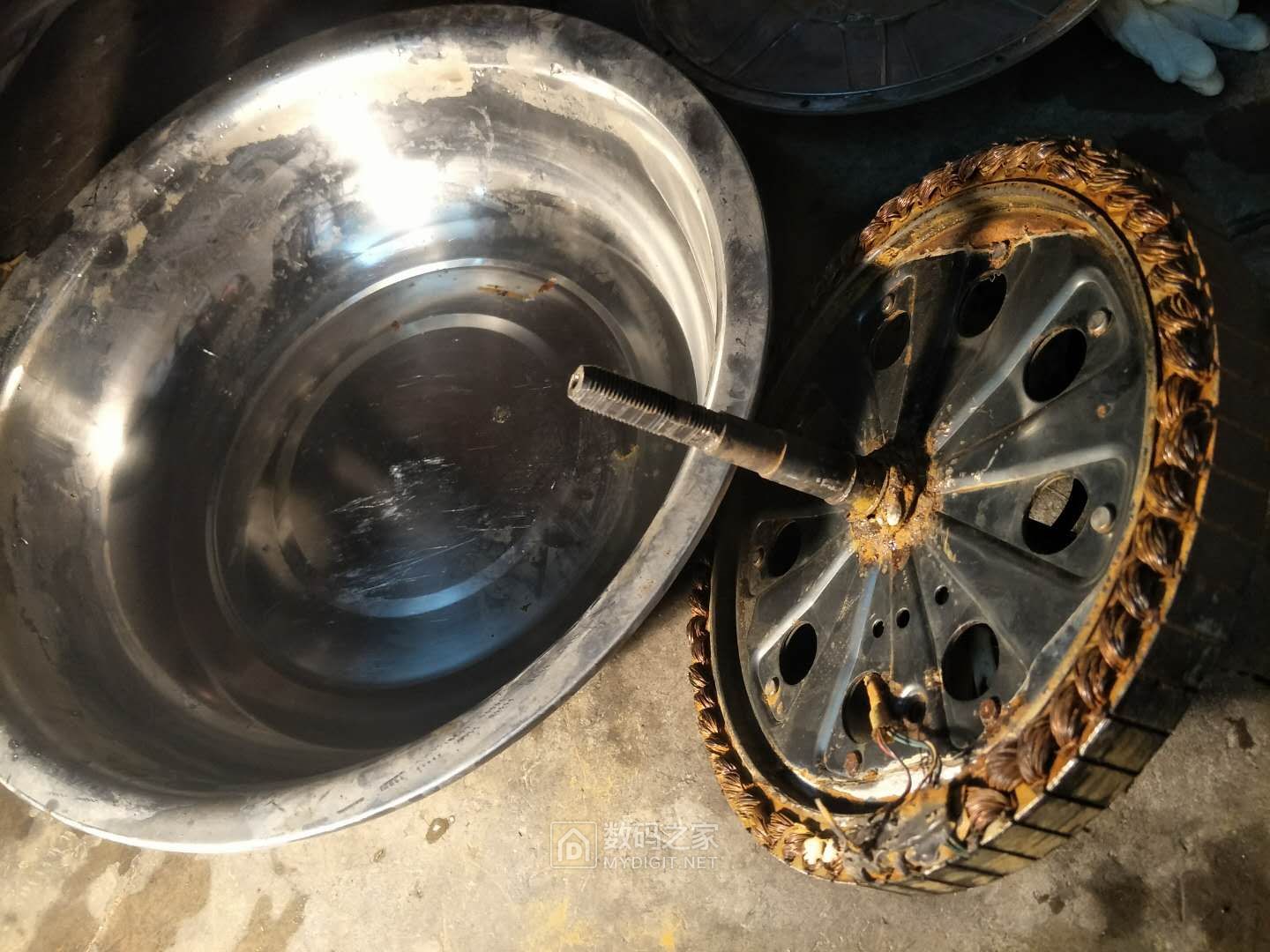

[size=3]天哪,这压根是放水里泡过嘛。[/size]
[size=3]我也是第一次遇到这种情况,[/size][size=3]现在把拆修过程发上来,跟坛友探讨下。[/size]
[size=3]
[/size]

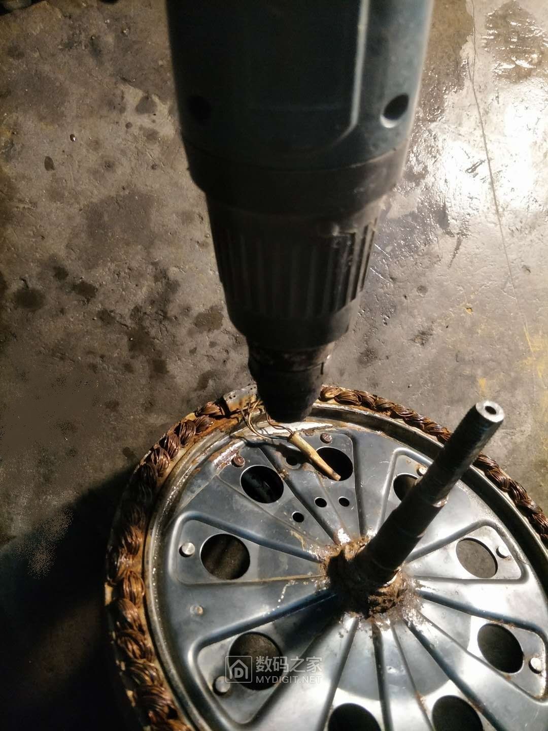

[size=3]漂洗(一盆清洗后的脏水倒掉了才记起拍照):[/size]
[size=3]
[/size]
[size=3]
[/size]
[size=3]
[/size]
[size=3]去胶:[/size]
[size=3]
[/size]
[size=3]
[/size]
[size=3]吹干:[/size]
[size=3]
[/size]
[size=3]
[/size]
[size=3]
[/size]

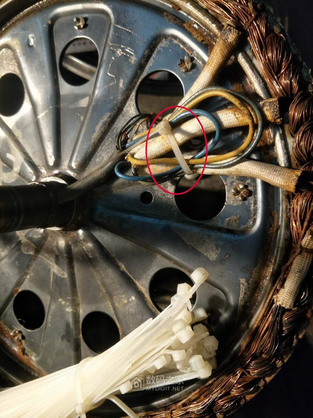

[size=3]上回扎带:[/size]
[size=3]
[/size]
[size=3]
[/size]

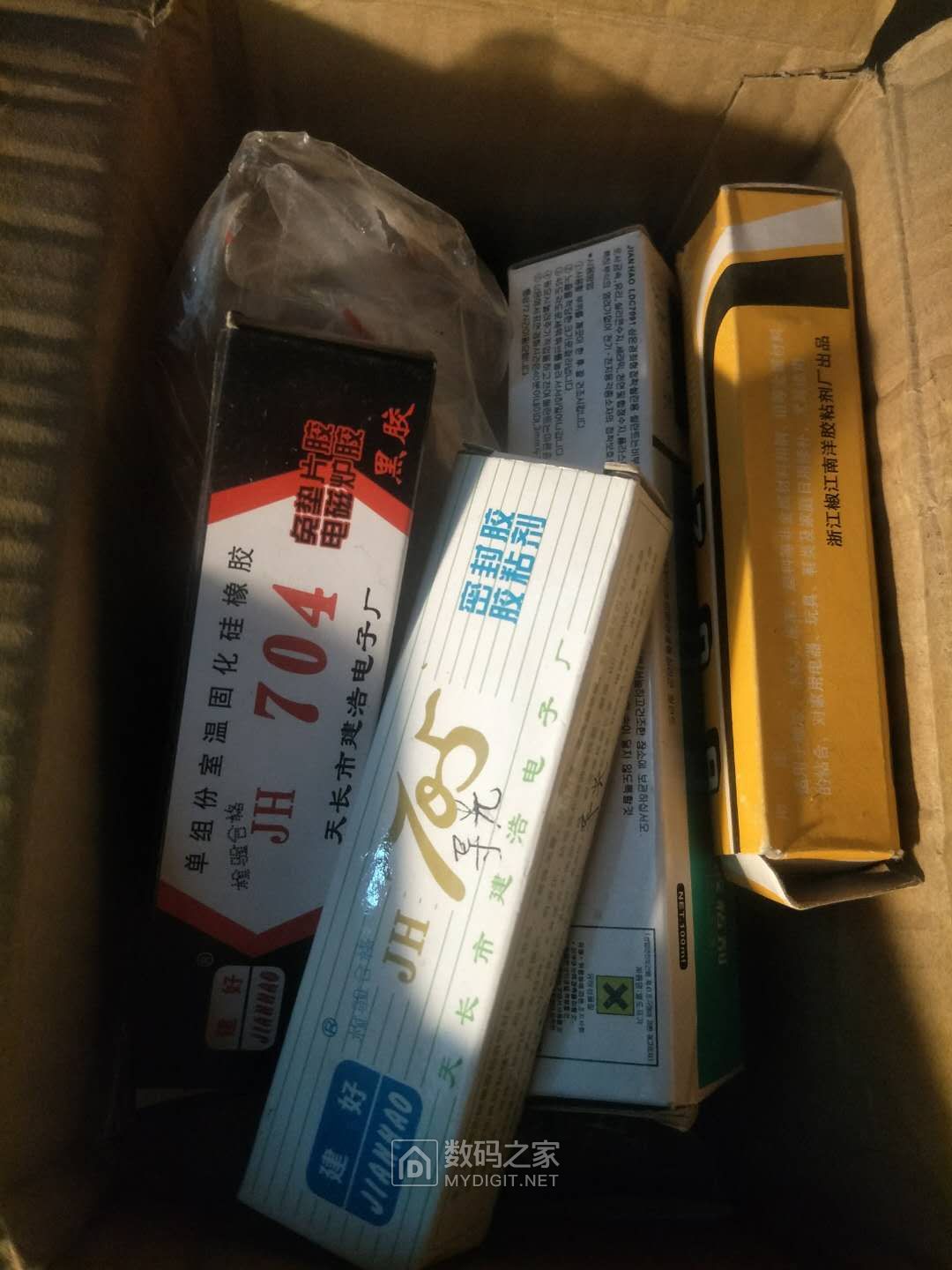

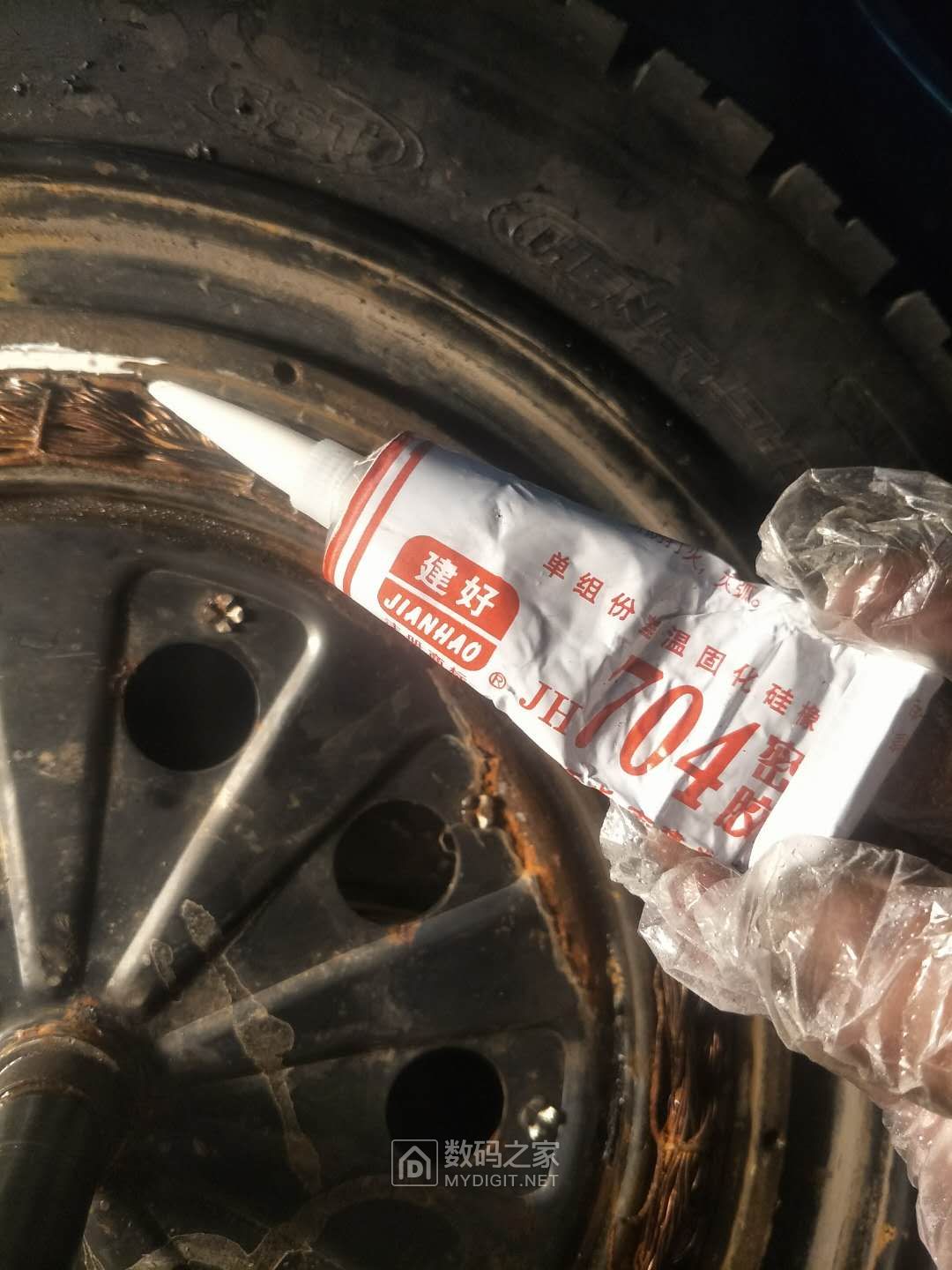

[size=3]上胶:[/size]
[size=3]
[/size]
[size=3]
[/size]
[size=3]
[/size]
[size=3]
[/size]
[size=3]
[/size]
[size=3]
[/size]

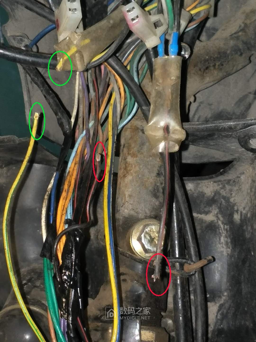

[size=3]回装发现还是不能动([/size][size=3]不是开始时的整个车轮卡住不能动,现在[/size][size=3]车轮已能用手转动,只是拧车把依然不能动),发现刹车灯不亮,排查发现是老鼠咬断线了:[/size]
[size=3]
[/size]
[size=3]
[/size]
[size=3]
[/size]
[size=3]
[/size]
[size=3]
[/size]
[size=3]
[/size]
[size=3]
[/size]
[size=3]重新接回。不知是不是电池亏电了,还是不能动。在充电中,待续……[/size]
