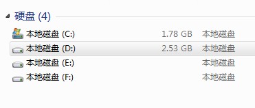

固件是CDADCCHA03
JMF608开卡工具下面的信息固件是ADCCBAHA.bin,系统固件是GDP.bin,然后
是不是告诉我是什么闪存颗粒?有4个闪存颗粒的空位,用了2个的?
工具基本所有信息都看到在的
亿储120G固态硬盘,放在硬盘盒可以识别,但是找到盘符提示未格式化,点格式化提示无法格式化,如此循环
使用分区魔术手\磁盘精灵都访问不了就退出程序了
装进开卡器,短接固态硬盘主板的ROM,找到硬件
打开开卡软件,说找不到
这些代码是说FLASH颗粒的 ID吗
Flash model : MT29F512G08CUCDB (Micron)
Channel number : 4      Total bank : 2
Capacity : 111.8 GBytes     ECC mode : BCH 40
IO drive current : 8 mA
Defect block percentage :  3.0%
Reserved block percentage : 12.6%
ECC read error threshold : 39 bit(s)
ECC error copy threshold : 35 bit(s)
Bank map : 00 01
F/W version : JMSSD_1000940120103943,Jun 25 2015,15:37:57,608A,CDADCCHA03
Support : (V)Remap (V)Trim (X)DeviceSleep
Customer ID : 000D
                  Flash Info (0x0A1B)
Flash type : MLC
Blocks/CE = 2048(16G)      Blocks/Flash = 8192(64G)
Pages/Block = 512         Bytes/Page = 16384
# of CE : 4       # of Die : 2
              [Factory](Block)   |                       [System](BlockU)
            early_bad  later_bad | early_bad  later_bad  Ecc Over  Prog Fail  Erase Fail  Ecc Fail
CH=00 CE=00    51          0         6          0          0          0          0          0
CH=01 CE=00    49          0         6          0          0          0          0          0
CH=02 CE=00    57          0         6          0          0          0          0          0
CH=03 CE=00    41          0         6          0          0          0          0          0
CH=00 CE=01    64          0        12          0          0          0          0          0
CH=01 CE=01    50          0        12          0          0          0          0          0
CH=02 CE=01    56          0        12          0          0          0          0          0
CH=03 CE=01    49          0        12          0          0          0          0          0
SUM           417          0        72          0          0          0          0          0
(One BlockU equal to two NAND flash blocks)
Power-On Hours Count=7234
Power-On Cycle Count=3237
SSD Protect Mode=3
SATA PHY Error Count=65535
Maximum Bad Block Number of Die=10
Total Bad Block Count=72
Later Bad Block Count=0
Average Erase Count=126
Power Loss Count=284
Temperature: Current=25  Min=30  Max=60
